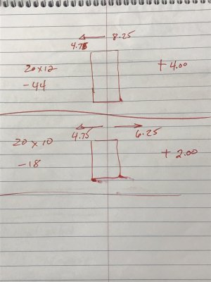

I calculated a few different sizes when I was looking for wheels and made this guide. The first is my stock 20x9 wheels and the rest are common sizes/offsets. The number to the right is how much further they will stick out than the stock wheels. Left is inward backspacing, right is outward.
Just a guess but you probably want a 10” wide -24mm to eliminate those spacers.
