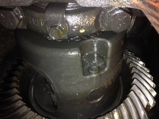

What's wrong with this picture?

Yikes, the clutch cut through or broke through the case. As many broken Trak-Lok carriers I have removed and replaced I haven't ever seen one like this.
lharrell79
Nov 23, 2016
454
240
2008
4.7
Did the clutch pack actually go through the carrier, or is that just a chunk sitting there? Also, you ring seems to be missing some teeth. Looks like a good time for upgraded gears and lsd. I've been very happy with my Auburn.

If you didnt already order everything let us know if we can help. We offer Yukon gears

Lol I remember when I opened mine to find the same thing. Broken clutch disks, missing teeth in ring gear and major pitting in the bearing race. Wish you luck and have fun with the new little project
