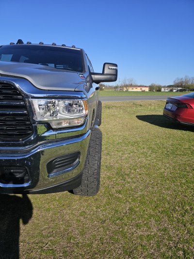

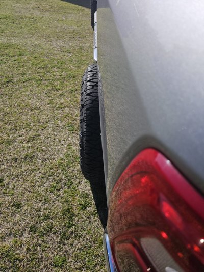

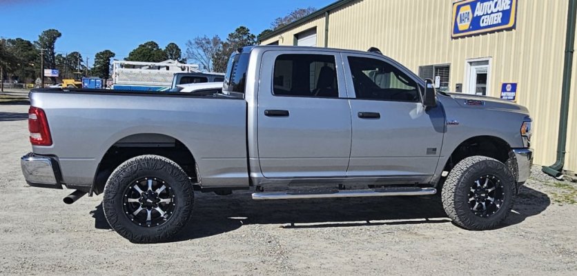

I have a 5th gen 2023 2500 Tradesman 4x4 with the 6.4 Hemi. I put 35x12.50R18 on Moto Metal MO970's 18x10 -25mm offset with 4.5" back spacing. Tires stick out fender wells a good 2-3" and they only rub at full lock on outside backside fender liner. Guts talk about cutting it but I took a heat gun heated plastic up and pushed it back so no longer any rub. I was told they would rub on factory radius arm but they don't at all.
