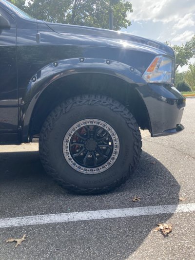

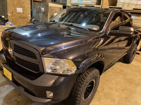

Adamcr68
Mar 28, 2020
816
1,537
Lorton VA
Hemifever 5.7
I just prefer the look of 17s over 18s. Mainly trying to see if anyone has any pictures of a what a -12mm offset would look like
I have 17x9” -12 offset on my truck, it’s an express not a warlock, tires are right at the edge of the flares.
I also like the more tire look of the 17’s.

Thanks so much that helps a lot. It seems as though I will have about an inch or two of tire outside the fenders on my truck considering I have removed the fender flares.
