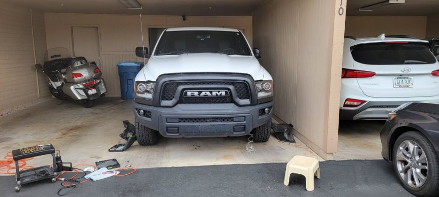

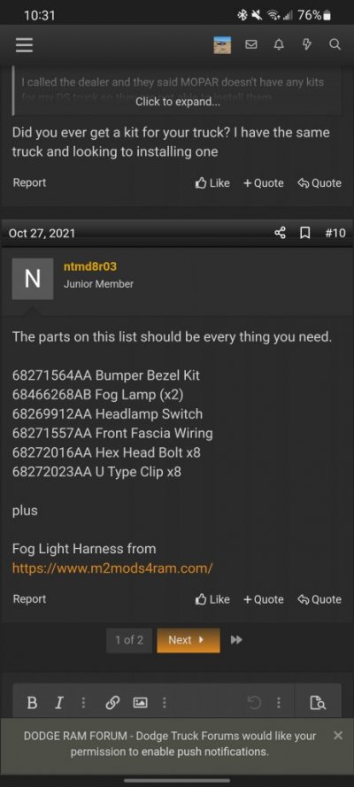

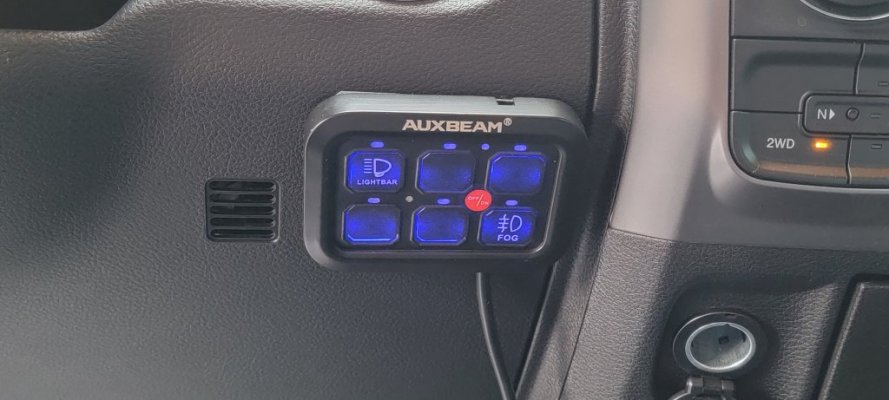

I just installed them in my warlock the only thing I did different was use a auxbeam switch panel instead of the stock switch. If you have any questions let me know.oh yeah the wire harness in the list is not correct but I modified it so was not a big deal. Hope this helps you
