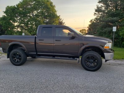

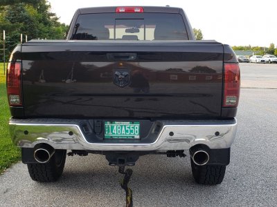

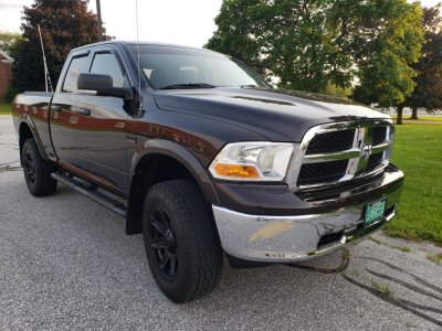

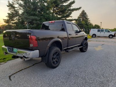

1.5 for me also. It's sits right where I want it now. I have Bills at 2.8 and 1.5" spacer in the back and the BL makes it perfect.
I only installed 2 of the crush blocks cause I did not want to take off my fender liners again. they are a pain in the ass with flares. I also could not get my hane in there to put the push pins in so they are just wedged for now. Someday I will address that.
Over all went pretty smooth and rides great. No rattles etc.
I did find out you do have to remove grill and headlights to get chrome bumper back on cause the bumper cover had to come off.
The zone instructions do suck and I also referenced the RC and PA 3" instructions
