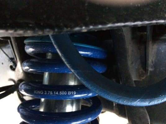

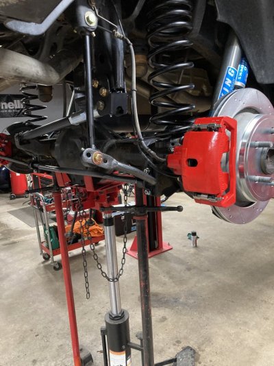

I share your opinion, the front lower control arms & front sway bar, I did replace the original as it had a lot of rust, are still stock but the rest of my suspenion is after market.
My truck drives/rides much better IMO, my boss has a 14’ and is a leave it stock kind of guy, was surprised how good my truck handled when I let him drive it.
