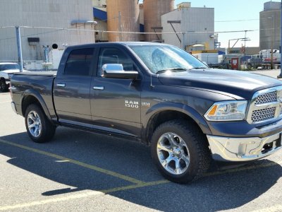

I run the rancho quicklifts with the zone uca's no prob on stock rims.. Bilsteins are great as long as your not on the very top perch.. They are much stiffer than the ranchos..
