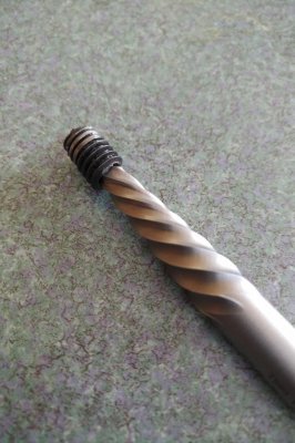

I broke a bolt on my diff cover a couple days ago. Not the first time I've broken the head off a bolt so no panic. I drilled out the centre of the bolt the usual way. Centre punch the middle and proceed to drill it out for an eazy out. This time however the eazy out broke in the hole. Now panic set in as there was nothing to grab to get it out. After breaking and wearing out most of my drill bits I found a solution. I have a rotozip that turns around 25,000 rpm and I picked up a 1/8" HSS die grinder tip and slowly but surely ground the eazy out out. Of course if you have an actual die grinder that would work better. Took 2 bits, but I got it. What I learned was you can grind an eazy out out if you have the time and will, drill as big a hole as possible to get the biggest possible eazy out in there and buy quality eazy outs. Also my hand is steadier than I thought as no threads were damaged and I cut it pretty close.
