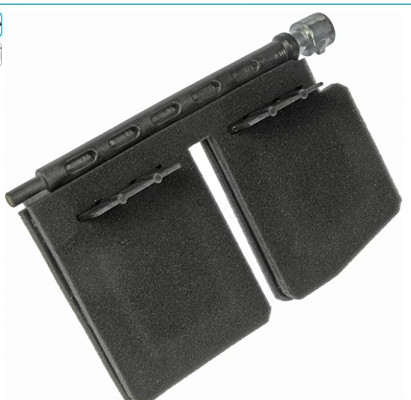

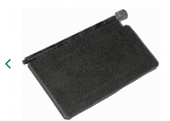

Thank you, I have removed the dashboard and found the blend doors were broken, the once I have been able to find for 2007 look like image 1 however the once in my 2007 ram look like imange 2, this is why I ask if the 2006 RAM blend doors would fit the 2007 RAM.
