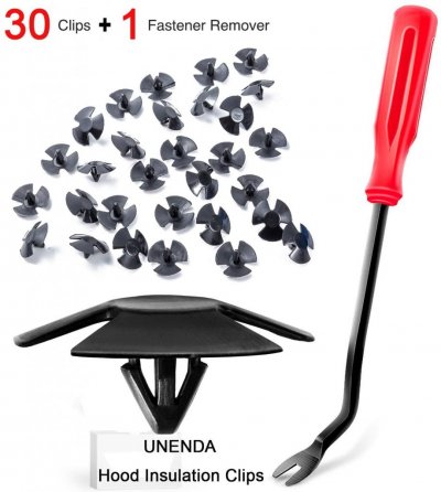

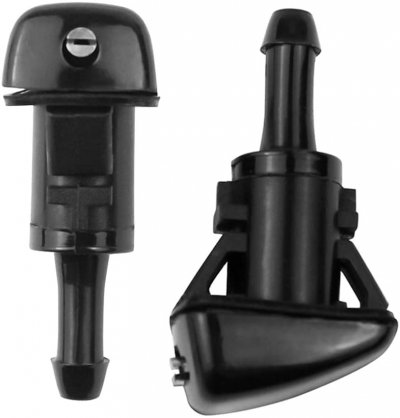

One of my windshield washer nozzles stopped working. Investigation revealed that the hose under the hood was off because the nozzle connection broke off of the nozzle because the plastic was brittle. After 11 years I suppose that's normal. After opening the hood I had to remove the under hood insulation. Its held up by 7 plastic clips and you will need something like a trim removal tool to get them off. All of these will break as well due to age. So, here is what you need to order to complete the job.
1) UNENDA 30PCS Hood Insulation Retainers (30pk + removal tool -> Amazon $7.99)
2) AMFRNE Windshield Washer Wiper Nozzle, ADJUSTABLE, Mist spray type (2 PK -> Amazon $13.99)

1) open hood, remove underhood insulation clips and insulation, set this aside.

3) Use a heavy duty set of needle nose pliers and squeeze the tabs (front to back) on the old nozzles while pushing up. They should
pop out through the hood. You might as well replace them both while you are at it.
4) Make sure there is no debris in the tubing. In my case the plastic broke off in the tubing and I had to squeeze the rubber "T" and "El" with pliers to crush the brittle plastic and fish out the pieces with a drill bit by hand. Blow out the tubing with air. then prior to final assembly, pump washer fluid through it to make sure its cleaned out.
5) Use the gaskets supplied with the new washer nozzles and pop them in from the top of the hood. They should click in place.
6) Hook up the washer tubing being careful not to break off the underside of the new washer nozzles. Test them to insure they are working properly.
7) Replace the underhood insulation with a new set of clips. Now shut the hood.
8) Test your new washers again, note they have brass spray nozzles and they are ADJUSTABLE up, down, left right and you can change the angle of the spray as well. Adjust as necessary to get the best spray coverage.
