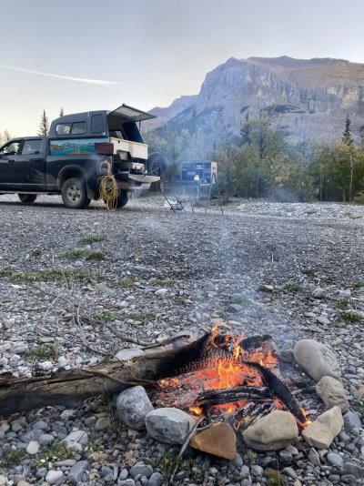

My uses are similar but I live in Edmonton so it’s a drive to get to good wheeling. My truck is my daily driver so I can’t get to crazy with mods. Most of the things I have done is to make my truck a better camping mobile.

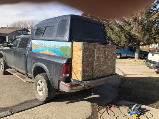

These pictures are from before I built the “doghouse “ on the back I found that I kept kicking the doors open. I have a little diesel heater that heats the back

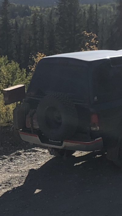

Here’s a better picture of the tire carrier I built in the red ammo can is the diesel heater it gets it’s fuel from the gas can beside it. There’s 2 12 volt batteries in the bed to power the heater and the topper lift.

Is there a reason you did a tire carrier off the back? From what I’ve read, the 35 can still stuff into the stock location with a bit of wiggle and massaging?

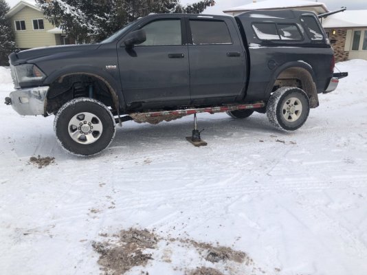

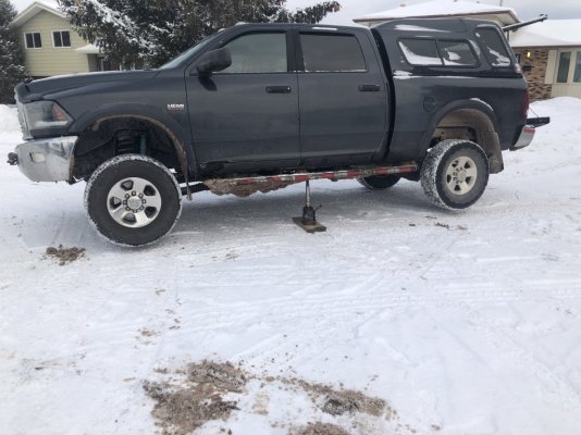

When I bought my truck new off the lot times were good and I planned on buying lots of stuff for it. Times changed so I had to build the stuff that I wanted but couldn’t afford. Like rock sliders the ones I wanted ( white knuckle off-road)while probably a fantastic product as I see them on lots of trucks on YouTube. They were to spend for my budget. So I researched the materials that they were using and I got some locally. I already had a welder etc. I bought a cheap plasma cutter and crawled under my truck and built my own. I think that they are just as strong as the other ones.

If you’re out wheeling and get stuck with a flat it would be a pita to get it out. Also I plan to put an auxiliary fuel tank in the spot the tire used to be. And those cheap a&! Winch’s that they use to hold the spare up are known to be apita
