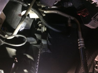

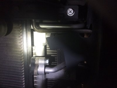

Im a 3500 with the 6.4. I can't see much without taking it apart here are some pics
First pictures through the grill on passenger-side a radiator
Second picture is hood open passenger side of radiator
And obviously the pictures are flipped 180° I don't know why

OK sorry about the ****** pictures they're actually really ****** up I think mirror image for some reason but they look fine on my phone. that happened when they got uploaded for some reason.
So I put my son to bed and had a little bit more time to look and I do not see the infamous TBV.

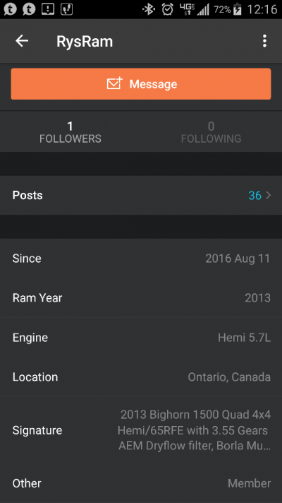

He has a 4x4 per his profile ...?
