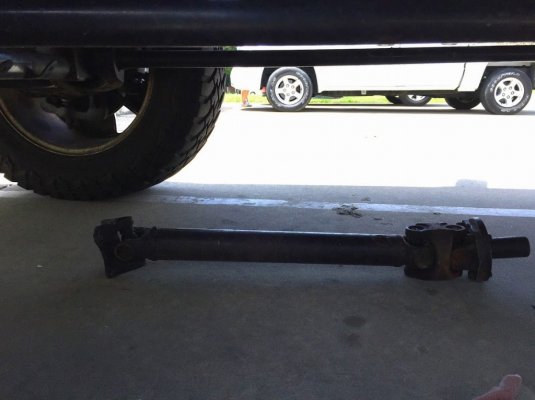

Also the paper work says a front drive shaft for 740$ but there is no part number or anything so i don't know if it is aftermarket or what but this is what it looks like and how it sits installed

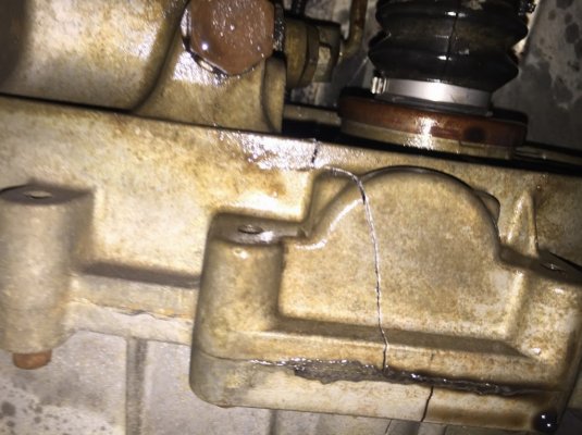

So when i bought the truck it rumbled really bad at 70mph but i thought it was just from the tires, but after 4months of owning it, the rumble turned into a shake and my transfer case split in half
After I replaced the Tansfer case, I never put the Front drive shaft back in and all was good. There was no rumble or shakes at all.

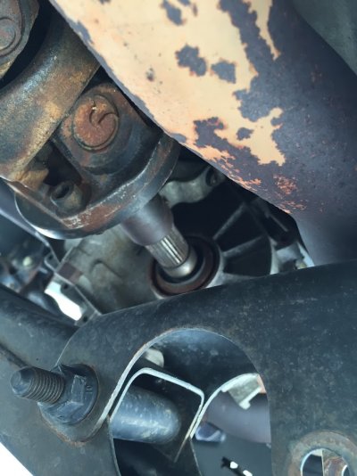

So now its been a few months and i wanted to use my 4wd so i put the front shaft back in and i have the shakes again.
My plan is to re-build all the joints in it, but is this thing after market? Should I buy a spacer(30$) for it to compensate for the lift or should I buy the clocking ring(240$) expensive?

The that low amount of spline engagement you need a longer drive shaft for sure. That's where your shake is coming from.... What's the angle of the joints on your front driveshaft. A 6" lift on a 1500 shouldn't require an indexing ring but if your angles are steep enough it wouldn't hurt.

To measure the angle exactly you would find out what it is on the driveshaft itself and then on the transfer case output shaft and find the difference between the two. However if you post up a picture of it I can take a better look and let you know what I think of it.

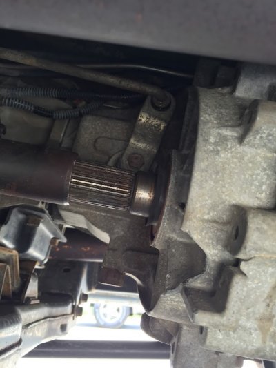

With only 6" of lift your angles should be fine , the lack of spline engagement is a definite concern! With so little spline engagement it's allowing excessive axial movement right at the splines .
Think of it like this : let's say you had a close tolerance fit bolt that was 12" long and you had 10"s of the bolt exposed ( sticking out ) the head of the bolt would move in any direction excessively, as opposed to the same bolt only exposed 1/2 " ...
