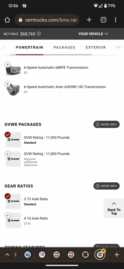

So, going to say right up front that your opinion about bags increasing your payload is wrong. But first: Based on your aim throughout this thread to get someone to agree our 2509s are underrated, your rear suspension is not the problem as the "math" of 6500 + 5500 is 11,000 GVWR. So why do you want bags? If the 2500 is underrated because the GAWRs add up to more, and your opinion olis that the trucks are built to handle more, then you don't have to do a thing; overload it and be on your way.Lol love the gif, thanks for adding humor.
I'm not looking for someone to agree with me or just tell me what I want to hear. I thought I made that clear many times. I'm just looking for sources to back up everyone's opinion. You have an opinion clearly, I'm not looking for door figures. Again, why could I register a truck in other states heavier then what the sticker says? Do you have any sources you could share? I'm coming to the table with an age old debate that has a strong following either way and no real answers, besides with "the stickers say so". I agree with warnings, but what are the real differences. There are plenty of people who decide to drive without seatbelts which is also against what the sticker says.
Trust me, I have no plans going over any legal limits and would upgrade if I had to.
My biggest fear would be if I went over the 10000 GVWR because of believing my OPINION that these trucks are the same, and the only difference is coils vs leaves, and if I add airbags I would be perfectly fine. I go down the highway with my family and 5er loaded up and my payload is 500lbs over, but with my opinion that the truck is plenty capable to handle it. I get involved in a crash, people go to the hospital, trucks totaled, camper is fubard. Now, the other driver gets a good attorney and an investigation is done, they find I was over my trucks GVWR. They sue me, now my insurance company won't cover me because I loaded up over the weight limit. Now I'm personally liable, out a truck, a camper, hospital bills out of pocket and "pain and suffering" for the other people.
You think I want that?? Absolutely not. I'm just curious, which apparently is a sin around here if asking for any proof anyone has that shows the 2500 could not hold the same as the 3500 if equipped correctly. People have a hard time saying, "I have no proof, I just feel safe with what the sticker says". Ok good, that's good you want to do that, I wouldn't think less of anyone. I'm just wondering if anyone has done any research or looked into it. But this forum takes it as an argument, when it's not.

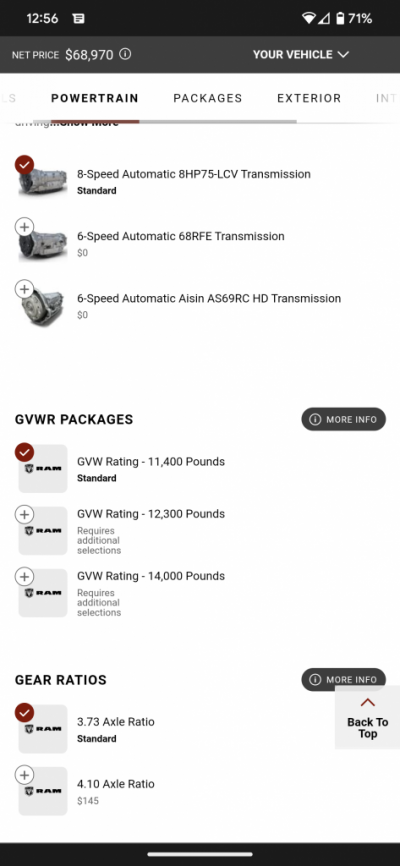

Yes, a bit sarcastic, but the numbers on your door are certified by engineers. The proof of what the truck has been designed to do is right there. Stellantis, much less any company, will never officially state a lesser-rated truck will perform at the same level as a higher-rated one, even if that were possible. That would be a class action lawsuit looking for a court to happen in: whether it is for all the 3500 owners who could have spent less to buy a 2500, or 2500 owners who start exceeding their specs and kill someone. I am sure you have read that 2500s have their GVWRs kept below 10k due to government restrictions and this may be true.
So....
What if Stellantis says a 2500 can exceed it's specs? How will they re-rate each 2500 already out in use so that we can all start using them for more weight? My point is your chasing an answer you will never get, and meanwhile some really knowledgeable people here are trying to help provide information to the best of their ability and, knowing none of us are Stellantis engineers you still get upset that we keep not giving you what you seek. All the talk about coil versus springs, and multi-connection points, etc. is trying to be informative, but at the same time it is (no offense intended) worth what you are paying for it. Beyond the factory-provided specs nothing else really matters and all of the really good information from this great group can't help you legally or safely tow/carry more.
At the end of this, the best answer is buy the tool that is rated for your specific needs.
