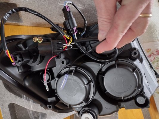

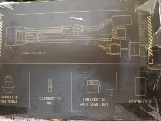

I am putting Alpharex pro headlights in place of factory projectors in my 2015. I have the adapter harness and am wondering if I can simply hook the wire on the harness right to the drl wire on the lamps.
Yes that wire is for the DRLs as the factory projector headlight wiring has the Dedicated DRL wire in the plug.
You can use AlfaOBD to set the DRLs to "Dedicated" so they function like factory. There also settings that you can turn the DRLs On/Off through the radio. Check the "Known Working list" in the first post of the AlfaOBD thread for the settings.
