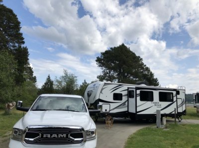

I tow an Outdoors RV 27BHS (33 ft) with my 1500 CC hemi limited w/3.92 gears at about 7800 pounds. Have a Blue OX swaypro and it tows great! Picked it up in Idaho and drove it back to Washington no problems at all. Since then I’ve taken it out numerous times no complaints other than a trailer that size can be challenging to park in a tight camping spot.
Pull-throughs FTW :)
