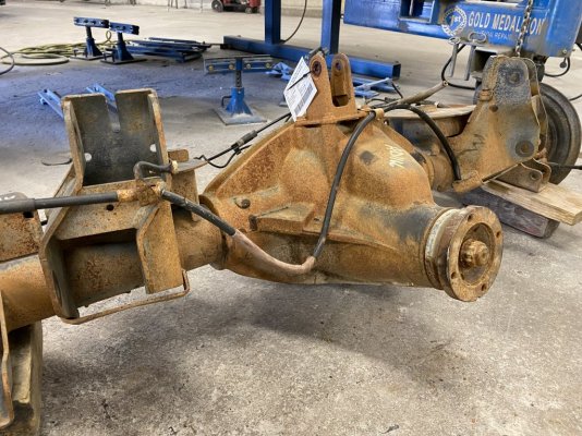

Well long story short I drove to my friends that ordered the 95k mile rear axle for $900. 1 year warranty.
Its not as clean as I was thinking it would be. My nice Texas axle still looks clean clean and this is very ‘crusty’. I will probably pass on this and eyeball one before I get it. This was ordered from a well known Kansas City recycle place. Thoughts?

Personally, surface rust on an axle housing wouldn't scare me, that's what wire wheels, sand paper and rust rustoleum professional gloss black paint are for.
$900 for the complete axle isn't bad if all the seals and internal parts are good

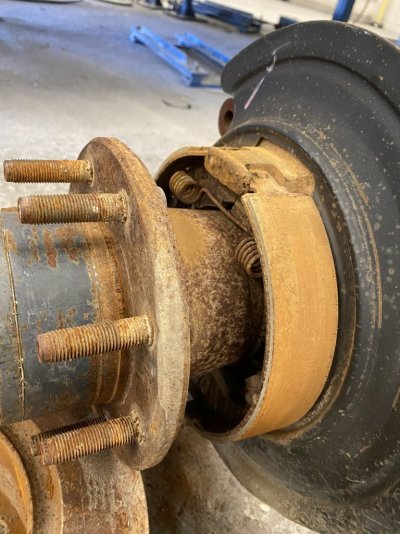

Surface rust is fine, the scale rust coming off I dont like on this one. And I think the Drivers side axle seal was/is leaking. I may just go look at a few before buying sight unseen.

It just looks crusty to you because it's been sitting out in the weather for a while. Take a look and listen to the insides and if it's good a littles work with a wire wheel and paint will do wonders.
All the rust on it is just surface rust.
