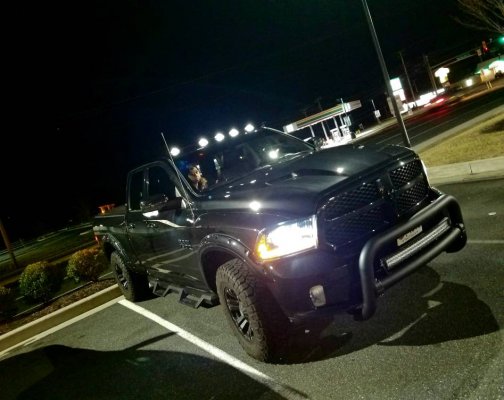

Thanks, I ended up getting them just had to get that right amount of pressure like you said some of the ones i could get to i put pliers on em. Had me freaked out a bit.
Install went smooth other than that, the template was a pain in the ass. I only took the front a pillars and sun visors off and I was easily able to access where I needed to get.
I did put a thin layer of silicon on the inner lip of the rubber seal just cause I'm paranoid. Wasn't a fan of the plastic nutsert Appling the sealing pressure. I tapped into my HID headlight wire for power. Works great! I love how they turned out but I don't know that I would ever do it again drilling those holes had me freaked out even though I measured several times1ba1899968bf1a6d03862e75e5be2380.jpg0af586ad64538db54841128bb229668c.jpg
