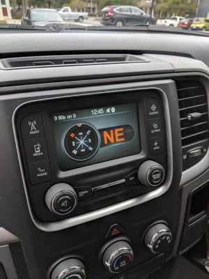

The AC Delco pigtail PT2779 worked perfectly.
I just got the compass module working.
Using the AlfaOBD app.
Show compass heading
Select yes
Compass mounting orientation
Select right side up
EOM presant
Select yes
Compass variance
Select yes
Compass calibration
Select yes

I really like your setup!!!
What pn# is the module you used? And do you mind sharing which wires from the A pillar went to which terminal on the module?
dav8388
Apr 23, 2018
362
207
Summerville, SC
In limbo between trucks
3.6 pentastar
The part number I used was 68105821AB. As for the wires the first post in this thread describes it better that I can.
