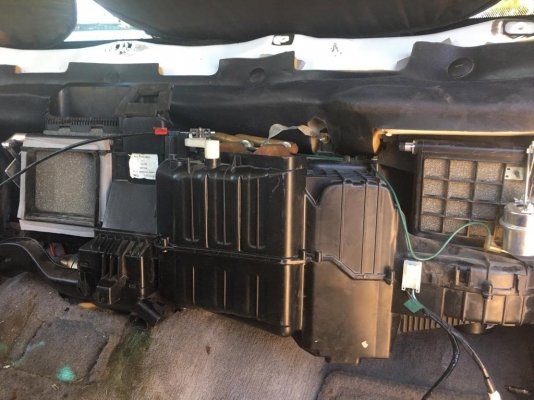

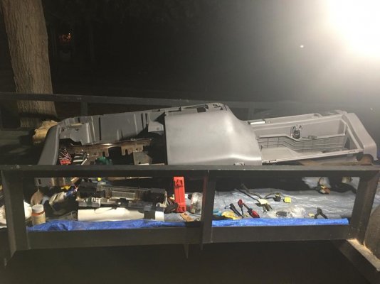

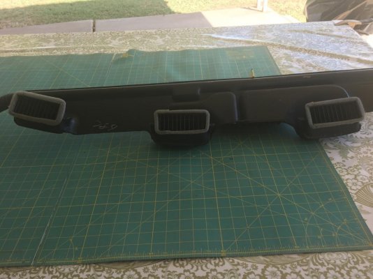

I’m in the middle of a dash swap out now. Bought a “new” under dash on eBay pricey. I paid $687 for mine). I bought a new top dash from LMC Truck.
I’ll be getting it back in this weekend. Been a longer road than I had imagined. Replaced all my vent doors with doors from Blend Door USA. Also replaced the actuators with mopar actuators. Blend Door did not recommend after market actuators...
Some pics:
