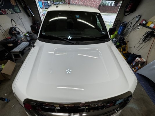

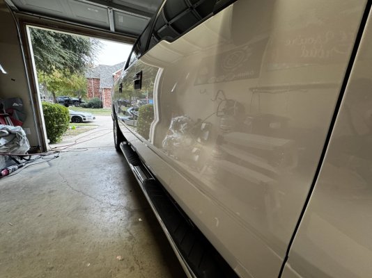

Yeah, I tried goo gone, goof off, 2 different adhesive removers from Turtle Wax and 3M. None of it worked. Had to go with the eraser wheel. Looks nice and clean now though...
a little advice to anybody considering doing this, more heat and less sawing motion with the fishing line. I messed my clear coat up in a couple soots with the fishing line.
