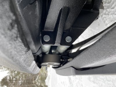

Put this on today. Going to change the cable out when it gets warmer. Lame thread but Incase anyone wanted to see a installed pic with stock cable here it is

I'm kind of curious on this.....what's the point etc? what am I looking at? Sorry I'm not familiar with power wagons a ton yet as I just got one but I'm not a huge fan of the hook hanging off the tow hook.....

Just a hook upgrade. very nice stuff. factor55.com has all the info there. Wasn't sure how it'd fit so I put the picture up incase anyone else was wondering

Looks good. I went with the same red colored Factor 55 flatlink. I really like how it gives the truck a cleaner look and the application of the closed shackle winching system.

Damnnnnnn they don't give those away. So then you just have to toss a shackle on the end instead of having the hook. which honestly isn't a big deal anyways. You're typically wrapping the hook around a tree and hooking back on it's self or whatever anyways.

I was contemplating the same exact thing so thank you for posting this because it definitely motivated me to just order it already.

I went with the ultrahook from Factor55 since it's seems to be the best of both worlds. Let's be honest though - I mainly got it because I thought it looked better than the stock Warn hook or even the flat link. :)

I think I should have gone with red too. I played it safe, oh, well

Nice choice! I have same one, but actually decided to have it stick out.
It just stopped up against the rollers. When I do the fairlead swap it will probably be further forward.

Ultra link looks sweet. just a bit over kill for me.

In my opinion, these things are basically mainly for looks. What purpose does it really serve anymore than hooking a d-ring to the factory cable loop? I mean you have to hook a d-ring up anyway, why not just completely bypass the flat link and connect it right to the cable?
But regardless, it looks good, and lets face it thats what most of us are after!

Attaching the hook “back on the cable” is generally frowned upon. Doing so can damage/kink steel cable, and is especially bad for synthetic cable.
Best/safest method is to put a tree strap around the tree(or other anchor point), join the ends of the strap with a shackle, and attach the hook to the shackle.

I definitely agree - if it was for pure function there would be no need to get anything besides the flat link. My first truck when I was 16 had a Warn winch, so nostalgia definitely came into play with wanting to keep a "hook" on there.

You know what I never understood about their closed system hooks? All one has to do is take the factory hook off and put a shackle on. Boom, closed loop system, and the “hook” becomes an irrelevant component in the rigging

yup, that works too. not sure if side loading the shackle on the loop may be a risk though? I really don't know
