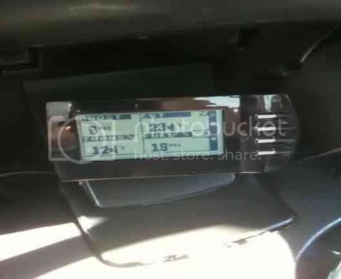

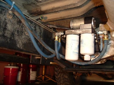

Makes total sense . So it is safe to say if you fall 10psi or lower ... look at the filter first , then kinks or blockage in the lines .
So I have a 3 psi fall ... how can I tweek it , or is it worth loosing sleep over ?
And that can be corrected how ?
