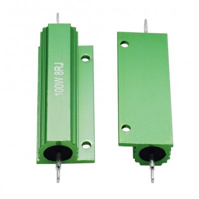

Any disadvantageous to running a aluminum chassis wire wound resistor over a ceramic in this situation?
I would be very hesitant to use wire wound resistors in an audio application. They could conceivably add impedance (AC resistance) to the circuit. The higher the frequency, the higher the impedance.
Best to stick to plain old carbon resistors in this situation.
The rest of us are using wire wound resistors with zero issues... for almost a year now.

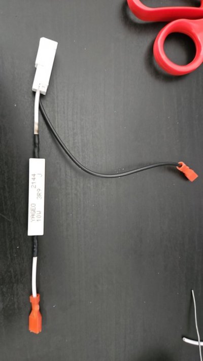

Just did this mod, could definitely tell there was a volume difference between one with and one without the resistor, but not as much as I was expecting. Nonetheless, I definitely prefer this over what I had before, and now I'm less worried about distortion or overly loud highs. Also, as someone else said, now I realize how crap my rears are. Need to upgrade those soon!
