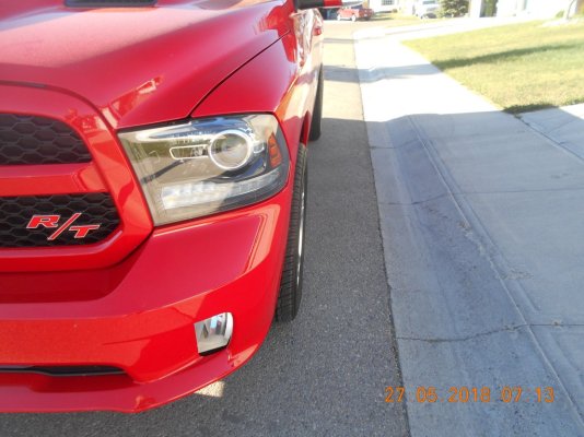

Roughly 3/8". I had my dropped spindles narrowed by roughly 5/8" ,but my truck is a 4X4 and they have a wider front wheel stance then the 2X4 trucks have.295/50 on the front on stock 20" Sport wheels
