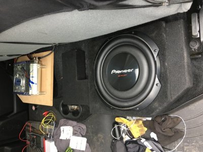

This should hopefully be arriving this weekend: 12" Pinoneer TS-SW3002S4 Shallow sub
12" 4-ohm shallow subwoofer
mica-injected resin cone
power range: 100-400 watts RMS, PEAK Power 1500watts
frequency response: 20-125 Hz
sensitivity: 93 dB
mounting depth: 3-3/8"
sealed box volume: 0.5-1.0 cubic feet
ported box volume: 0.65-1.0 cubic feet
Im going to wait till next month to get a better amp but I have an old Jensen A46XP = 460watts 2/1 channel bridgable
170 RMS x 2 @ 2 ohms
230 RMS x 1 @ 4 ohms Bridged
This amp actually fits in them middle of the RMS rating which is nice but I think due to the system being a single 12" I should get it closer to 300-400w RMS.
I was looking at the Pioneer GM-8601 Class D mono Amp
mono subwoofer amplifier
300 watts RMS x 1 at 4 ohms (500 watts RMS x 1 at 2 ohms)
800 watts RMS x 1 at 1 ohm
CEA-2006 compliant
Class D amp technology
variable low-pass filter (40-240 Hz, 12 dB per octave)
wired remote controls variable bass boost (0-18 dB at 50 Hz)
preamp inputs and outputs
speaker-level inputs via supplied RCA-type adapters
fuse rating: 40A x 2
Im also looking at this cheap rockville which does 400w CEA RMS @ 4 ohm but also says 800w RMS @ 4ohm. But has a 1600w peak power at 4 ohm which is basically on par with the 1500w sub rating.
