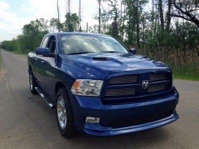

I posted a couple pictures earlier in the thread. And I believe I posted some in a thread when I introduced myself to the forum.
And the menu's on the radio were all in english. Just the actual language the music was in was french.
