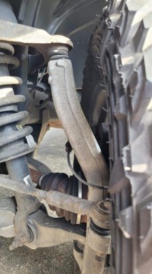

Here's -12 offset, pics always clear stuff up or confirm for me.
