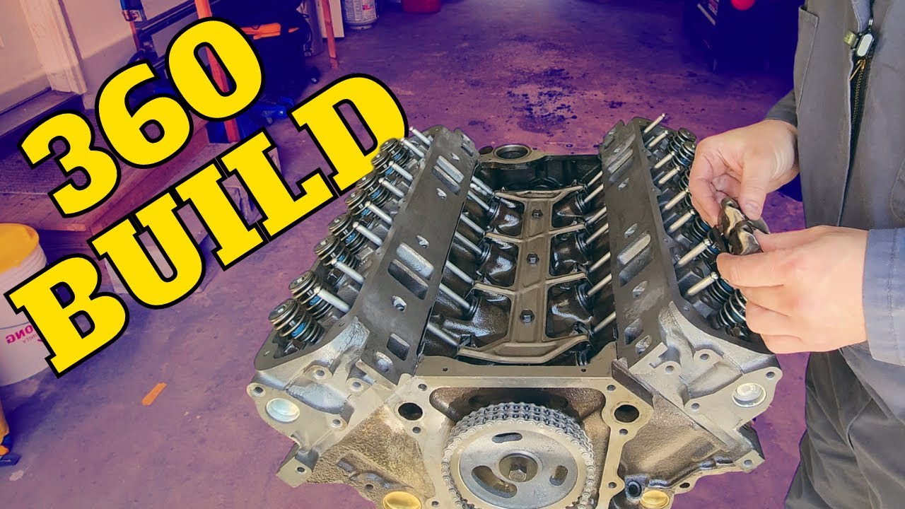

You should watch this video, it will help you to be more informed
