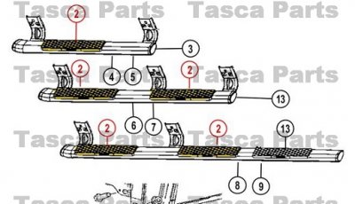

Here's a diagram.... look like they are all the same size unless you have the boards with 3 pads on it.

Like the bed rail caps, most of these things are a one time use and are really intended to be replaced if removed.
