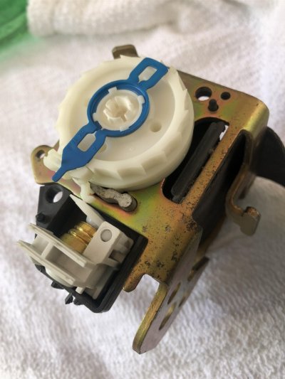

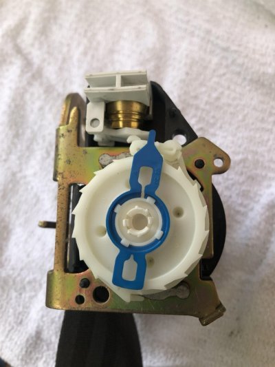

Hello I recently purchased some seatbelts for my 94' when I removed the ones from the junk-yard I let them retract all the way (big mistake) once this happens you have to remove the mechanism cover and adjust something on the inside. I cannot figure this part out, no matter what I do the seatbelt continues to lock up, I can let some of the belt retract and it won't let any loose. if someone has dealt with this before and can point out what I'm doing wrong I would really appreciate it YRNe192.jpg qTHengt.jpg GfGuYjK.jpg
any help or advice is appreciated.

What your wanting to know ...IS Possible to do ..& It's really simple . I don't recall that it is you do to it.
But I have a young friend that has worked at Body shops MOST OF HIS LIFE . & HE DID a set I'd bought ...
Go to a body shop or a seat recovering location.

I think maybe it’s the way it’s clocked, it should sit just like installed in the truck. This should let the locking mechanism to release.
