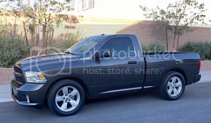

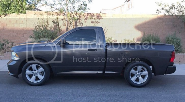

tires are installed! woot woot! I'll clean her up in the morning and take some beauty pics, I'm liking the stance!
M
moregrip
Apr 19, 2015
612
217
Nice brother! Looks really good! [emoji1][emoji1303]
thanks man......so far so good, front shocks are flawless, which I'm happy about because I sorta built my own T-bar setup, lol......very smooth to drive but takes the hard hits like a champ. I will say the clunking in the rear suspension is starting to get to me a bit.......especially on bad roads(really kinda horrible).......but I'm not throwing in the towel just yet......As far as looks go I think most people look for less space in wheel gaps than what I have but I've always preferred to have some gap:naughty: if I'm being especially picky I think I'd like another 1/2" lower all the way around.......more to follow.....I have other observations to discuss but still getting my thoughts together.
edit: oh yeah, muuuuuuuuuch better drive out of corners with the new rubber!

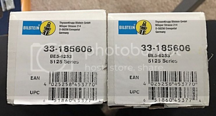

Very good apparent build quality on these shocks:
Fronts showed up today:
I may have missed it, but what were the details on these shocks? Like what part numbers?
Bilstein is a great brand of shock if you get the right ones, that's for sure.

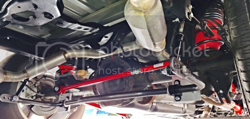

Well I'm happy with how it all went together, no apparent binding or clearance issues........ please excuse the grade 5 hardware for now as that's all I had on hand in all the different sizes to make the magic happen :grd:
The Hellwig adjustable rear end links supplied with the bar worked perfectly; so no need to buy different hardware there.
I need to go drive this thing!

Bilsteins are designed to be installed label up. If you look at my pic of them mounted up front and the comparison pic vs the stock shock you'll notice a few things #1 the main body of the Bilstein shock is chassis mounted vs lower A-arm mounted on the stock shock...........why does this matter........well in the grand scheme of performance suspension mounting the main body of the shock to the chassis vs A-arm lowers unsprung weight, which in turn increases performance! I didn't even realize this was the case until I installed the shocks.
guess what else I learned? I mounted my rear shocks upside down! lmao........I **** you not........right now they are mounted with the Bilstein labels upside down with the main body of the shock mounted to rear end..............luckily I'm swapping out the stock shock bushings with urethane so I will fix this ASAP.
What's so damn cool about all this is that I didn't even realize what I was doing with regards to minimizing unsprung weight using these 5125 shocks. Now, in addition to some badass digressive valving I have effectively lowered unsprung weight both front and rear :favorites13:
Yeeeeeeeep. Inverted shocks are a big deal in the motorsports world, along with other features.
It has quite a few advantages, the first of which is less unsprung weight.
Another one is fitment. Generally the body of the shock will be the smaller part of the shock because of dust covers on the shaft. That means the smaller end is up high which is usually where you have clearance issues with the wheel or control arms. Furthermore, on a coilover, it puts the coil down low, which minimizes clearance issues since the coil is larger than the shock body.
Last one is adjuster location. On a conventionally mounted shock, the adjuster for the shock is normally on the top, which is usually pretty hard to get to. On an inverted shock it's on the bottom and MUCH easier to reach into and adjust.
