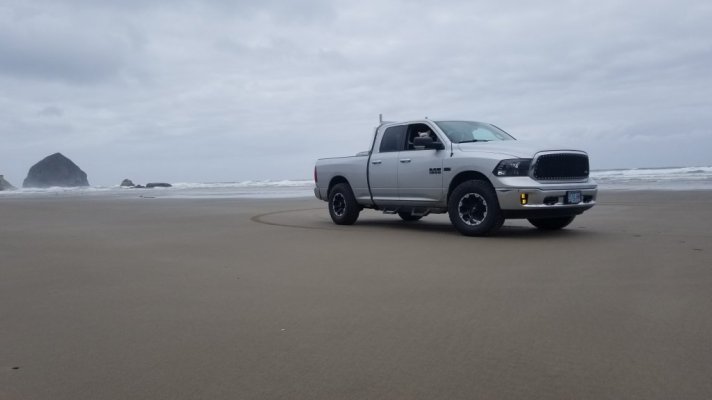

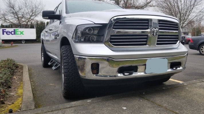

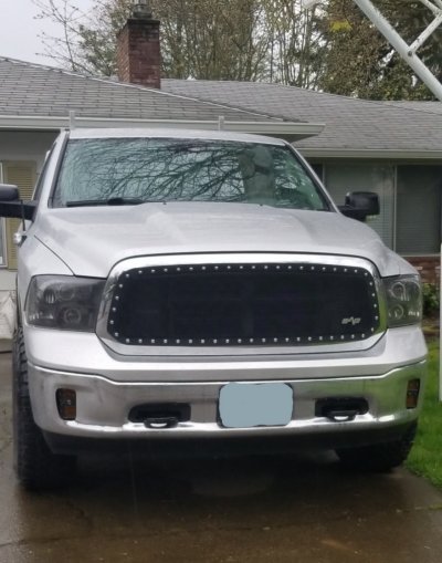

My 2014 had active shutters. I did a center cut out mess insert with active shutter delete. I saw no issue at all even took my truck in for warranty work and nothing was said. You might need a paper back and breath.
That is exactly the type of grill i was talking about earlier ...nothing wrong with not having them
