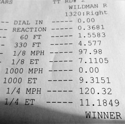

For drag racing you want to use the smallest diameter rim you can (your 17's) and a tire around 28/29 inches tall so you have some sidewall to flex and help with traction.
I run 305/45/17 Mickey ET Street R's on both the truck and car,and both pull sub 1.6 60fts,but i wouldn't daily them,as they're not the best in the rain,and they also have a relatively short life span as a street tire.
