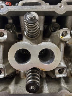

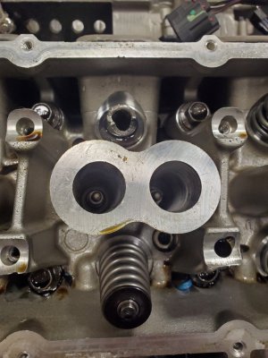

To summarize, the valve retainers manufactured by Comp Cams was not correctly heat treated (our guess) and failed which allowed the valve to drop, kissed the piston and valve fragments were pushed into the intake which pushed on a fuel injector thus forcing the injector upward and bending the fuel rail. Comp Cams was not going to cover engine damage initially but last I heard they will. If this was myself doing the work I bet they would not have but since a reputable shop (which is a dealer for them) did the install they have some pull and covering parts and labor, or so I was told.

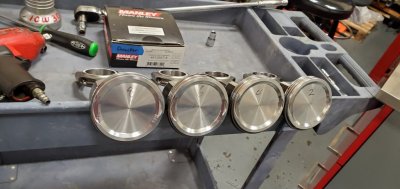

Motor is back out. Piston, connecting rod, head and block are shot. Unable to find a replacement 5.7 block so we are looking at a 6.4 block using the same Manely crank and rods from 5.7. This would give me a 426 or there about. With a 2650 screw blower running 13 psi should put us easily into the 850+ range, or more. Depending on tune.

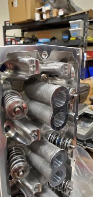

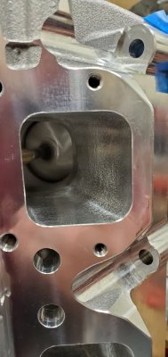

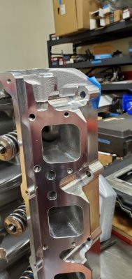

The 6.4 BGE block is finally here! This block is very similar to the hellcat block (oil squirters, longer oil / coolant galleries, extra webbing for strength, etc) but painted black. We have decided to go with Hi-Tech heads which allow a different valve train geometry leaving room for dual springs and locks. We are a few weeks out before this gets back on the road. Excited!
