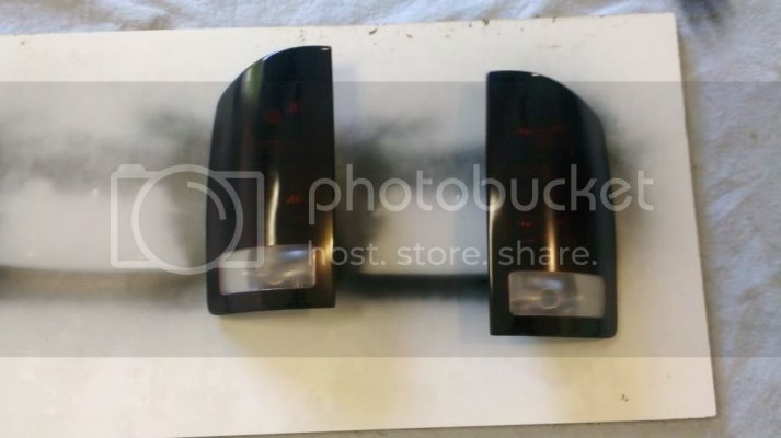

Did 2 coats, took a razor blade and picked a corner and slowly peeled it off. I think they look real good. Going to do a wetsand here in an hour or 2 (give it about 4hrs of dry time, then clear it and let it dry overnight.
Here is where Im at now

Looks good! Did you take em in the sunlight to see what they looked like?

Not yet, it was raining outside by the time I had everything done. They are not blacked out though, you can still see the red shining through which is what I was after.

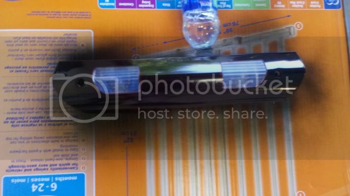

Oh and the blue you see on the clear parts of the lights is the tape coming through from the back.

Id put like 3-4 coats of clear then let dry for few hours wet sand then compound them they should come out like glass.

They need a wetsand before the clear goes on, there are a few imperfections in the paint that you can feel.

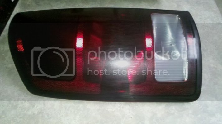

Second round of wet sanding done, clear will go on in the morning
Im reallly liking how they turned out, they are dark when not in direct light, and a dark ruby color when the light hits them just right.

Clear coat is going on now. God they look good

5 coats of clear
Just got to wait for them to dry for the final wet sand and polish
