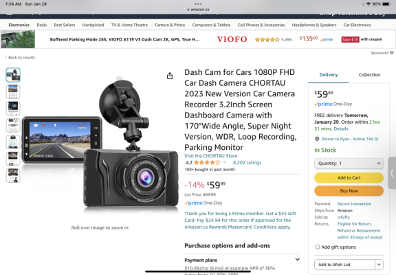

Don’t overspend on your dash cam. Regardless of brand, they all use one of two sensors. They all come with a bunch of useless features that you will never use. I’ve got a simple Amazon Chortau dashcam that was $55 3 years ago. Got one for the girlfriends car, too. Pick where you want it to hang; run your cable; pick your video length; set the time; shove an SD card in it; learn how to save clips and never think of it again.

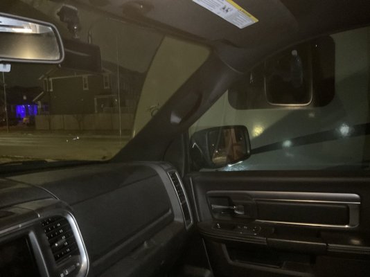

This is one of the better dashcam review vids: https://youtu.be/4AnyhHl3_tE?si=JNG_dvbR4SqX_arY

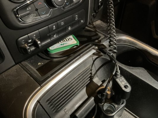

I’ve got the camera right beside the rear view mirror on the right side. I have a long usb cord. It runs from the top of the camera in between the windshield and headliner under the top of the plastic a-pillar liner then between the liner and rubber door seal down to the passenger footwell. It then tucks up under the plastic of the glove box and out through the center storage cubbie of the center console where it plugs into a splitter for the cig lighter socket.

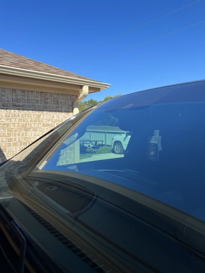

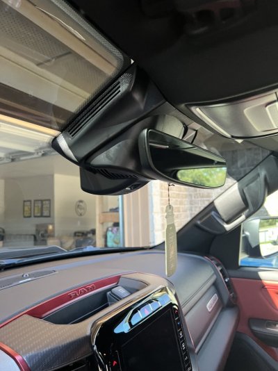

I have it installed on my Ram Rebel. I've had it about 3months. Install was pretty simple. I wanted something more oem style. Price wasn't all that bad..yeah I probably will never use the app much, but no worries for me..so far no issues, I've downloaded a few of the videos to see both front and rear camera. Works for me. No wires showing, nothing to stick to window, nice clean look and most people don't even know you have it which is even better.

How did you run the cable? I like the OEM look.
Edit: I just watched a video, so you just plug in the lower and good to go.
