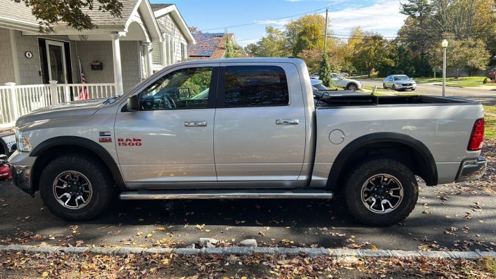

anyone else have Rebel wheels and tires on their 1500? I put them on my 2017 1500 but confused about the tire pressure. my 275/60/ 20's were 40 psi. the rebel door sticker says 45 rear 55 on the front. the tires are 285/70 17 bf goodridge KO2's. I asked my tire shop and he thought 55 was crazy. he thought 40 psi was fine all around. Any thoughts
40 PSI sounds great to me.
Whatever the placard says on the other vehicle is quite irrelevant.
You can try out the pressures indicated on your 1500 to see if you like the performance.
I have 245/75/17 E-rated BFG KO2s for my winter wheels and usually use 40/42 R/F.
They're spectacular in deep snow. On rare occasions, they might slip a wee bit when I start from a full stop on steep hills with hard-packed snow but only when it gets really cold out.
Keep in mind that with added pressure, you may negatively affect traction when it gets colder or deeper snow.
My former truck, a '07 Tundra, was very finicky for tire pressures. I normally ran the tires at 2 PSI above the placard value of 33/30 R/F because the roadway ate the tires at that low pressure.
During the winter, with BFG KO2s, I had to run the placard pressures because it would just spin at most intersections.
I've run the Ram truck as high as 43/45 R/F and it still performed well, the 40/42 pressures are a compromise that I can live with.
You can always try the chalk test while experimenting with new tire pressures.
