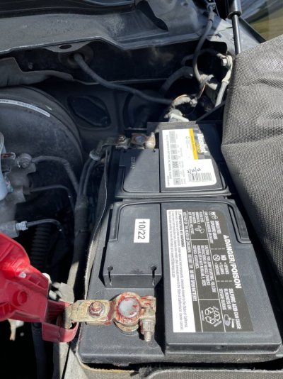

Well, ok ...your terminals look clean. Ordinarily I would say, have the battery checked (load tested). You could swing by Harbor Freight and get a cheap battery load tester and just verify it's good. When my battery went out, I'd driven my Ram all over in the AM ...then it suddenly wouldn't start. There was enough voltage. But it failed the load test spectacularly. At least it rule out battery issues. It's possible your alt isn't charging enough and the battery has just run low.
