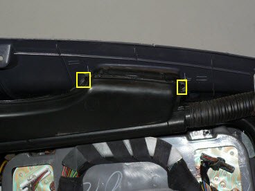

I fixed some of the broken plastic support structure with 1/2x1/8 aluminum strip epoxied in place to add strength
Attach the side molding and side defrost vent tubes to the dash panel before attaching the dash panel to the dash (do both sides).
Using a dremel tool I had to widen the slots on some of the duct connetors in order to get them to attach to the dash defrost vents without having to put pressure on the dash panel to make it fit. I would not be surprised to find that many dashes from the factory crack because the plasic panel is stressed to make it fit the ducting.
