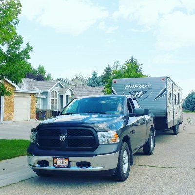

If you've never had a camper... the 1st season will be a clustefork... Don't worry about it! The reason I say you should set the hitch up after your loaded and after your first season is because you will change so much. You'll throw crap in your truck then one day get sick of loading and make a permanent spot IN the camper for it. If it makes you feel any better... my V6 RAM 1500 could pull the trailer your looking at. It's WELLLLL within all RAM 1500 HEMI compacity
