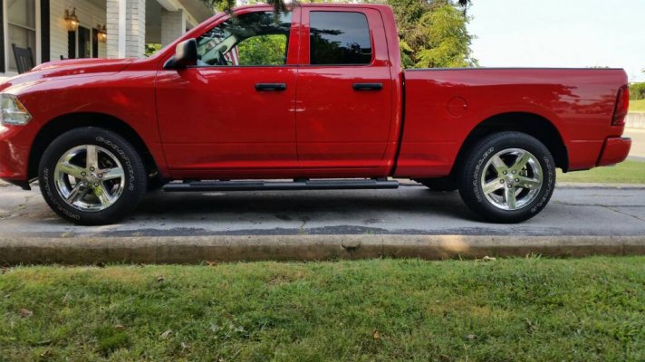

pro comps set at 2.7 which actually truly only gave 2" of lift

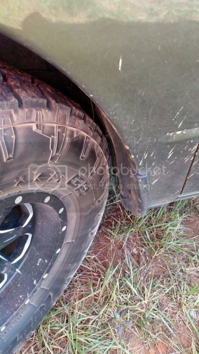

Mine is set at 2.8 with a 1" spacer in the rear. 35x12.50r18 on 18x9 -12 offset wheels. They rub a little on full lock.

Looks good Dema. Does it rub on the back of the bumper or on the swaybar? With that offset it looks like it rubs on the back side of the bumper/liner. I'm thinking a 1/4" spacer for my stock 20x8 wheels or some +1 offset 20x9 wheels which puts it at about the same backspacing. It only slightly rubs when at full lock turned drive. It doesn't rub at all at full lock turned passenger??? Weird to me, but I guess that's Chrysler's variances?

Rubs the plastic inner fender behind the tire when I'm turning left going through a dip or bump.

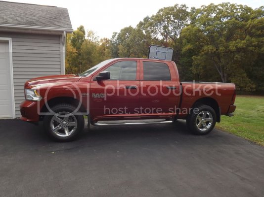

6' RCX with Bilsteins set at 2.8, see signature for all information. No rub.

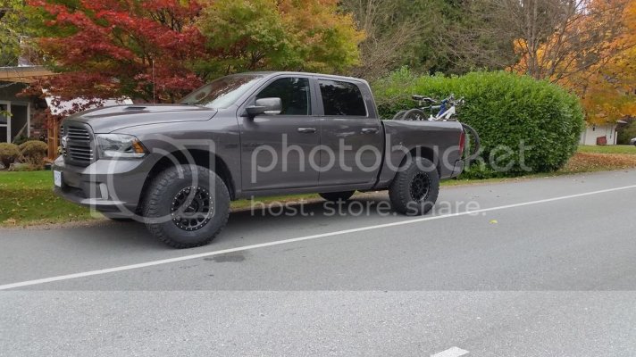

2.8" Front, stock height rear. 1/4" nose high, will solve with new rear springs soon.
Looks great, are you going to get some harder spring rates to compensate for any squat now that will cause the nose to lift up?
Love the bikes in the back man, i was an avid mountain biker and downhiller :):favorites13:
