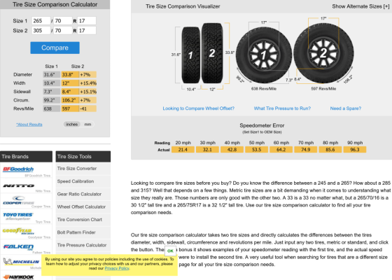

What size tire is currently on the truck?
The 295/70/17 is 33.25" tall.
The 305/70/17 is 33.81" tall.
The stock 265/70/17 is 31.60" tall.
The 295's are 1.6" taller and the 305's are 2.2" taller so you will see a performance difference for sure.

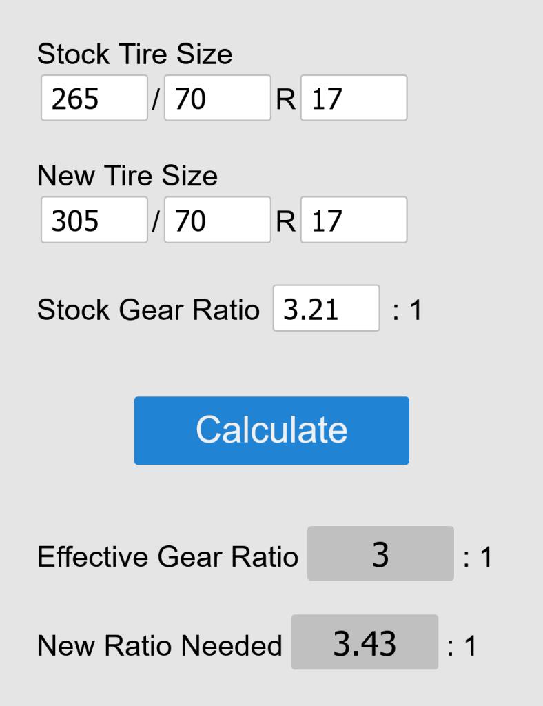

Simple enough to run those through a tire compare calculator. It will tell you exactly the rpm/speed difference from the height change. In addition, wider tires have more rolling resistance so combined with taller tires effectively making 3:21 gears into 3:0 somethings or even less, yes you will definitely see a difference. Except for right off the line, you can offset that using tow haul mode or setting the gear limiter. That said, you are in no danger of getting a nose bleed off the line with the 3.6 with stock tires, I doubt you will really notice the difference.
