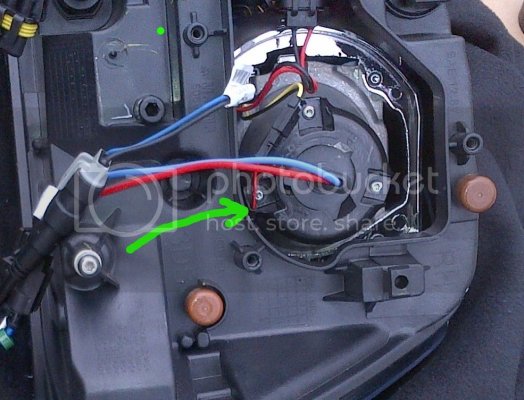

Actually you're mistaken,
The Stock Ram 13+ OEM Projector lamp does in fact have a solenoid activated
cut off shield.
The connection shown here
This is my previous set of OEM lamps I installed over a month ago
(now running TYC's with FX-R retro fit)

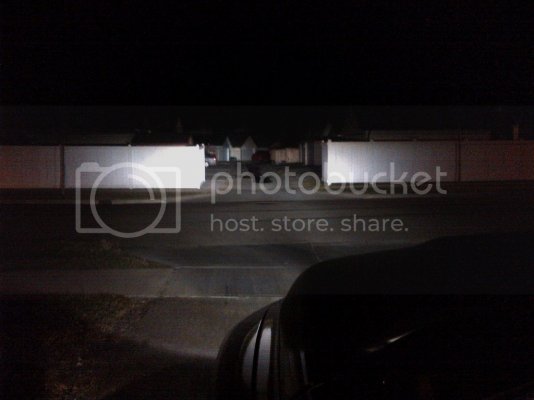

Low Beam Mode (with 35w/5000k HID drop-in kit) stock halogen hi bulbs and fogs
Hi Beam Mode removes cut off shield on projector and turns on halogen high bulb

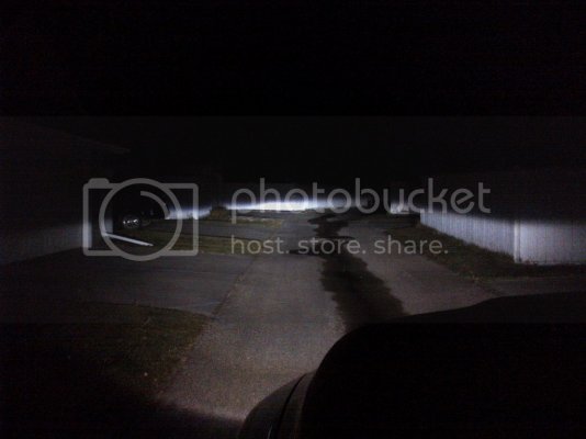

Low Beam Mode
Hi Beam Mode (clearly visible on the right side fence that the cut-off shield is gone)
Low Beam
Hi Beam
The HID in the projector is so overpowering you could toss the halogen high beam and never miss it,
if it wasn't for an annoying bulb out warning.
The reason its still included is because it functions as the flash-to-pass
(pulling the lever towards the driver) and functions even when no other lights are turned on.
Moving the selector lever fully forward (when your lows are on) towards the dash engages
the high beam mode that drops the cut-off shield and fires the high bulb.
The reason you should never put an HID bulb in the high bulb socket is HID's need time
for the ballasts/bulbs to warm up and are not suited for being flashed off/on constantly.
Dropping the shield in the projector never effects the HID's power level,
it only changes how much of the light is exposed to the lens ;)

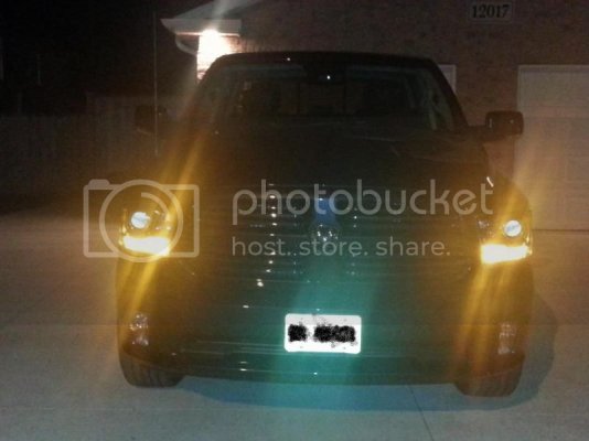

Your Ram runs amber LED's at full flash brightness for daytime running lamps
...Like this:
My halogen high bulb still operates as my DRLS at half power, just like my quads did :(
(no easy way to fix that, its computer controlled)
So on my new set of FX-R'd heads I had Jeremy add LED Amber Demon Eyes to the projector
and tied them into my park lamp LED's. They are wired to turn off when the projector comes on.
So it looks like this now when I run my DRLS with park lights on

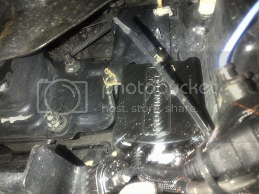

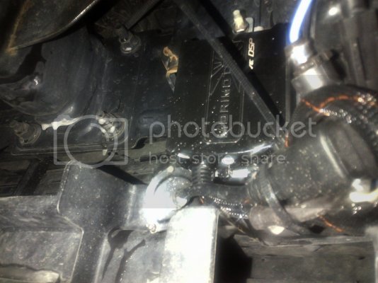

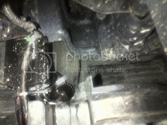

This may differ slightly from my 10' to your 14' Sport,
But after mounting the ballast bracket to the ballast
I laid on my back stuck my head under the front bumper looking forward
toward the backside of the front bumper for a hole to thread the supplied bolt/nut through.
Low and behold each side had a pair of threaded studs stacked vertically
...like this : and about 4" to 5" apart. I put the ballast bracket (and ballast)
onto the lowest one and tried threading the supplied nut onto it hoping for a thread match...it was perfect.
finger snugged it up, snugged up the rest of the wiring with zip ties,
then put an 8mm socket on the nut to torque it down solid.
Sorry, hard to get a good pic, but this was the end result (passenger side)
The fog light is just to the right of the ballast...
another angle that shows the top stud
Drivers side, shows canbus location too
