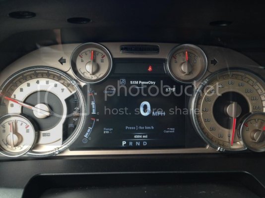

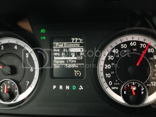

Ok guys here's the lowdown. Hated the plain Jane cluster I had. Nabbed a longorn premium cluster and installed it. 100% plug n play. All functions work as intended.
Mileage remains in the cluster though so ya need to be close in mileage.
Did I mention DIRECT PLUG N PLAY SWAP?!?!

Man this is a great mod for the express .. Does the digital portion read correctly as well
