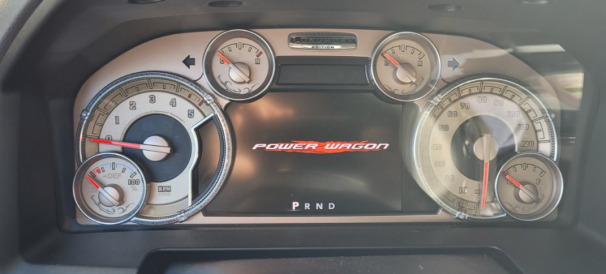

Took a bit more than a week shipped from FL to WA state but I finally got my upgrade. no more Black plain jane cluster.. hello longhorn... question.. it has a nag for oil change from the old truck.. how do I clear it since I still have a while to actually need the oil change? second when it boot up it says "power wagon" does it matter?
