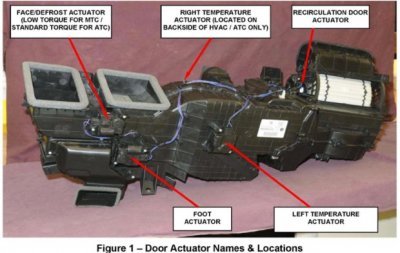

Another old thread bump.
My 09 Ram might have one of these blend door problems.
Driving home tonight and I only get heat on the drivers side. Passenger side is cool.
I read theirs a blend door behind the glove box. Would this be the one I need to replace?
Would these be #2 on the diagram?
https://www.justanswer.com/dodge/49lnj-dodge-ram-1500-heat-passenger-side-zero-heat-driver.html
Luckily if it's the driver's side actuator that's bad it's right behind the glove box. The passenger side one requires removing the dash.......

So if the drivers side one is bad the drivers side would be blowing cold? (I have the heat on)
If the passenger side one if bad the passenger side would be blowing cold?
Noticed this morning. When I put it on defroster on. It blows cold as does floor/feet position.
The rear seat vents blow hot though. lol

Correct, whichever one is bad wont be doing what you want it to do. Do hear any clicking?

Well, I just heard the tapping. Very light when I went to lunch.
IT's hard to tell which one it is, but if I'm getting cold air on the pass side. It's probably the one in the back.:mad::mad:
