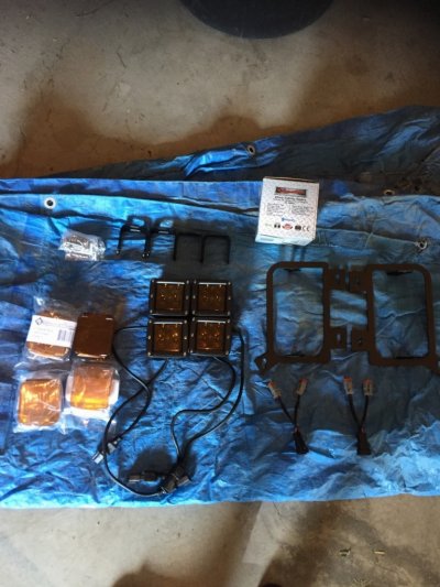

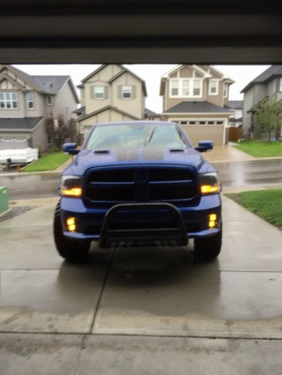

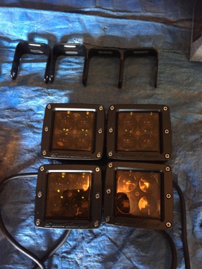

Hey guys,

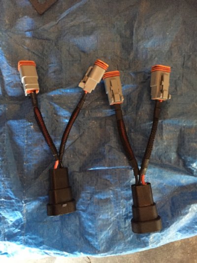

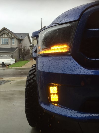

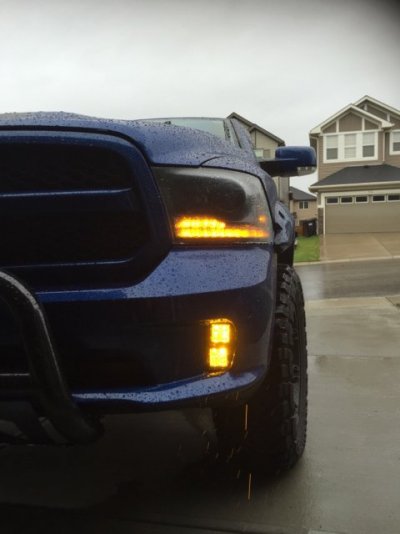

Thought I'd share an install I did with my LED pod lights. 73d018bd3ba960b033267964364d2936.jpg
This is the kit I bought.

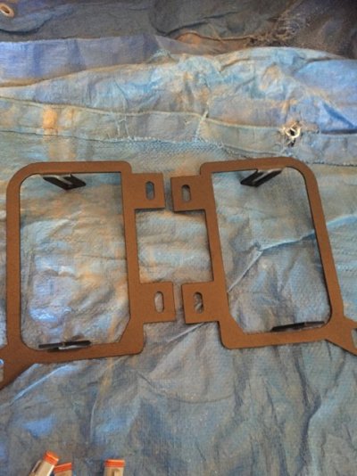

The bracket is from altered Offroad in red deer Alberta $85
They had the H10 to deutsch plug and play harness for $11 each

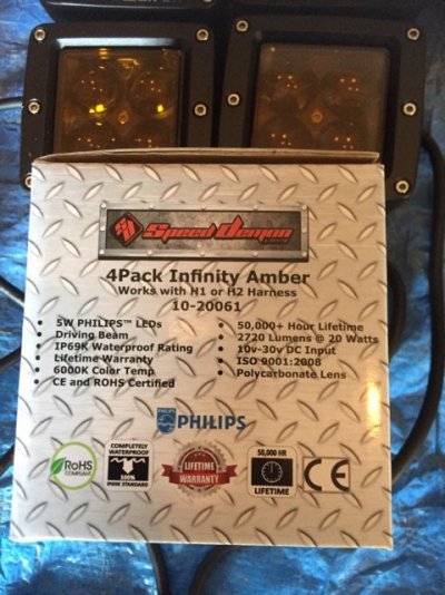

I used the speed demon amber pods. They each have a 2720 lumen output for a total of 10880 lumens for the 4 pods
Also bought the Amber covers from speed demon at $7 each
All in all it was a fairly easy install. My biggest issue was trying to find the Amber color to match the DRL lights on the Ram. Got pretty close, but did pick up some turn signal Amber model paint to put on the light itself to get it right on.
