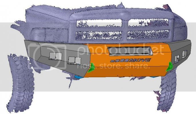

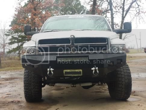

Here's the design

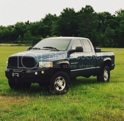

Here's what it looks like built

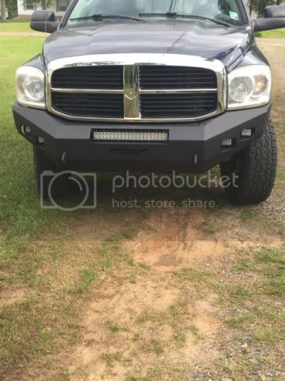

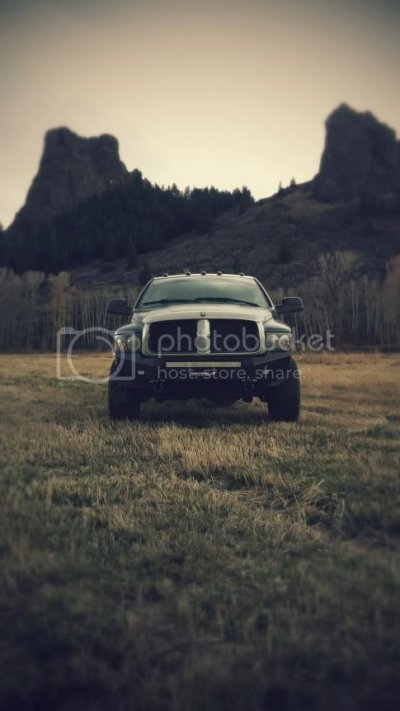

Here's one with the full guard

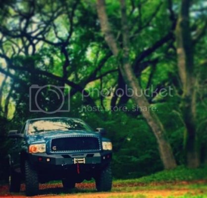

Here's some 3rd Gens
3rd Gen with a winch

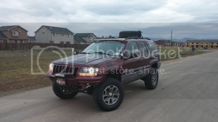

Ha my Jeep wasn't the fortunate cheap bumpers. 99 Grand Cherokee, cheapest winch bumper was eBay for $550 and you had to do some heavy trimming to get it to fit right.
Here's how it looked before blowing the motor up.

Thanks. Hope it turns out good. I made the thread to update with the outcome for those looking for a reasonable bumper.

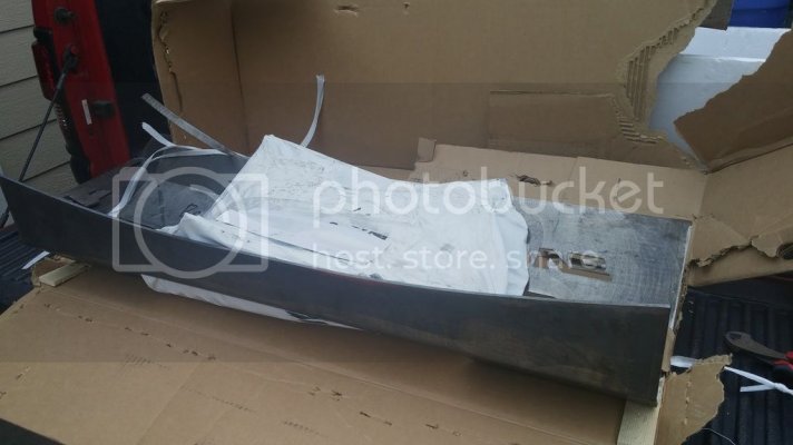

Bumper is here! I'll open the box tonight after hours and see what we're dealing with.

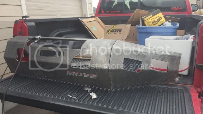

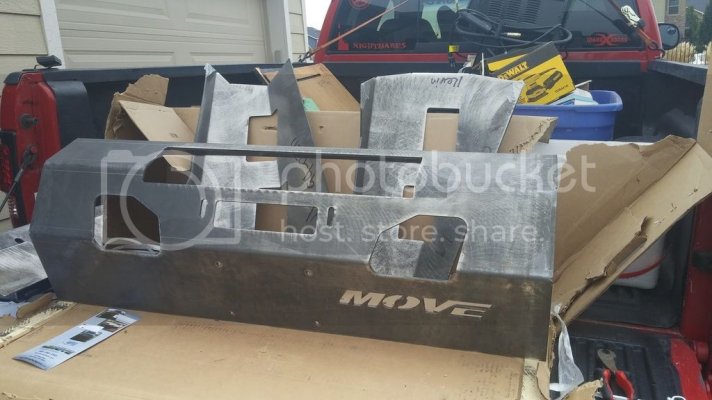

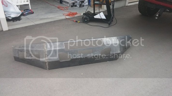

Alright, got started on it Saturday night. Got the wings fit and welded on. It went together easy, didn't fit 100 percent and required some slight modification to properly fit together, but all it all was very straight forward. There is hardly any instructions, some parts were labeled and some weren't, but nothing to cry about.
I got the wings tacked and ready to be welded by my co-worker, but after playing with it decided to just go for it. There's a few things that I'll have him finish up that I'll need a true welder for, such as the frame brackets, winch tray and shackle mounts. I don't trust my flux welder for safety purposes on items like that. But tonight I'll finish everything else up. All that's left now for me to do is weld the end caps on, mock and tack the light tabs, weld those in. Then mock and fit the winch tray, then tack it into place. From there this weekend I'll get the truck on a hoist and pull the factory bumper, then fit and tack the frame mounts on. Hopefully my co-worker will be free Saturday night to finish up the welding so I can get it sprayed. From there on Saturday night before heading home I'll run all my wiring for the lights, then come Sunday install the winch and lights into the bumper, then throw the bumper on the truck.

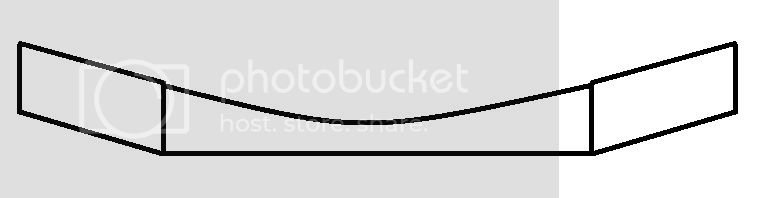

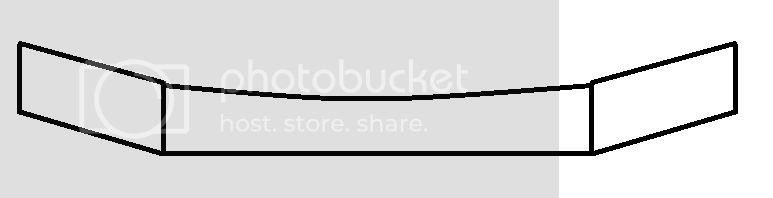

Something like this if you were looking at it from the top view.
Here's how it is now.
If it's not enough, then I'll just expand the radius on the cut already there. Like this.
